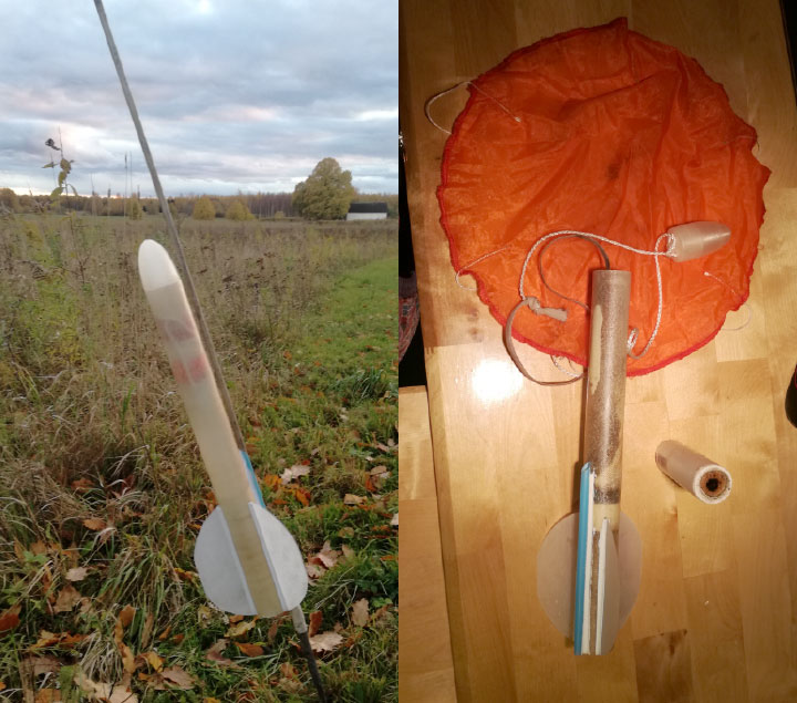

As others have mentioned, I have not seen the fibreglass tubes burnt from an ejection charge, rather just residue/marks. So just for clarity, are you saying that you made your own tubes using polyester resin and that is what is burning?
nils
Posts: 24
Joined: Fri Aug 18, 2017 3:19 pm
Re: bodytube inner surface and ejection charge - heat protection
Postby nils » Wed Nov 15, 2017 7:01 pm
Yes, I made my own bodytube with polyester resin.
Here is a picture of my rocket before the first flight and before 2 successful flights:
An area above engine block has turned from half transparent to milky. I made the second picture after washing the rocket.
The other white area is just white glue for bonding cord.
Posts: 1968

I suspect the discoloration/charring may be related to undercure of the resin.
Your comment that it gets sticky when hot supports this.
Since it's already had 2 successful flights, and you're only using low power motors, it looks like you'll probably get away with it.
If the apparent discoloration detracts from its appearance, you can always paint it.
