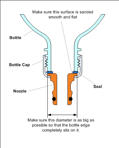

As far as removing the threaded section from the Gardena nozzle I used to use a hacksaw, and then file down the edges. (These days we just put it on the lathe and cut it off that way. )
Once you remove the thread and clean up the edges, put the nozzle down on some fine sandpaper on a flat surface and sand the top of the nozzle so it will sit completely flat against the bottle. Try to remove any scratches, ridges etc. and see if you can even polish it. The cleaner this surface is the better sealing results you will get.
Also make sure that the diameter of the nozzle that sits inside the cap is as wide as possible to give the bottle maximum area to sit against. If the diameter is too narrow, you risk the seal rolling off the edge when you tighten the bottle and then you would get a poor seal.
