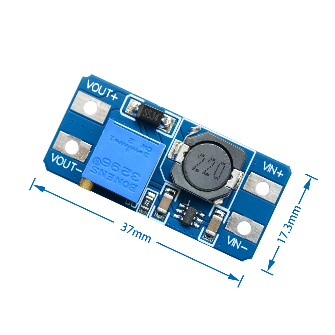

Did find a nice alternative for mid power (say up to 1A cont) applications on the cheap.
These super cheap boost converters have rather HUGE ripple with almost any load on them :
https://www.aliexpress.com/item/32366166138.html?spm=a2g0s.9042311.0.0.11314c4d5nPJ1F
datasheet of switcher: https://www.olimex.com/Products/Breadboarding/BB-PWR-3608/resources/MT3608.pdf
So when running off 4.2 down to say 3.3V boosted to 5V out with a 0.5A+ load the ripple is at least 200mV ie horrible. The reason being is that there is basically NO capacitance on the output.....(well maybe 1uF)
So I did a little test by putting a 100uF cap across the output and applied the same loading conditions, ripple dropped down to sub 5mV...
So for under $2 you now have a pretty decent adjustable boost converter good for at least 1A continuous, however heat sinking of the little switcher looks pretty ordinary so not sure how long it fare for long runs.. TBD
