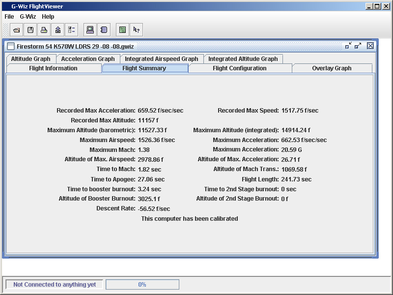

A topic on one of the US forums sparked my interest, and prompted me to start this thread.
Perhaps all the flier's who have actual evidence of their Mach breaking flights can list their data showing evidence of exceeding Mach and some information about the airframe configuration for the interest of others.
I will happily post the opening evidence.

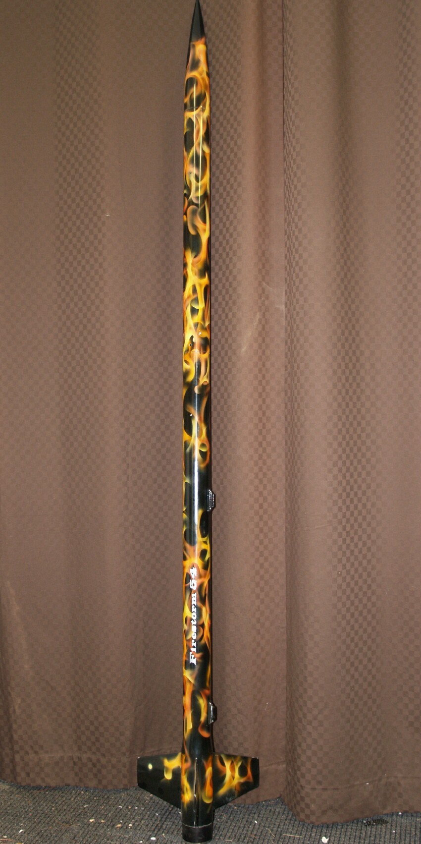

The airframe is a dual deployment version of the Giant Leap Rocketry Firestorm 54 in filament wound fibre glass, it uses an Acme fin can and weighs in at 4lbs dry and is around 71" long. It is a 54mm minimum diameter.
The engine used on this flight was a CTI K570 Classic with a total impulse of around 2062.9Ns and a burn time of 3.6s

I must say that all the people at the LDRS admired Scoops beautiful Firestorm ! Stunning looking rocket. 8)
Only problem, after 11500 feet flight, looking for it in the brown fields at 30+ heat ( lost the antenna from the transmitter) not so fun !! :lol:

Postby Scoop1261 » Mon Oct 06, 2008 10:32 am
Avachovy wrote:this is going to be interesting!
Im wanting to get me a Raptor, then ill join the club :wink:
You may not exceed Mach as easily as you think using the Raptor.
It is just short of optimum mass to break Mach, unless conditions are very favorable.
The only available commercial motors that would potentially achieve your goal are the H268R & I200W, and even they will only just achieve Mach 1.02 & 1.07.
C'mon folks, there must be more of you out there with real evidence of surpassing Mach 1.0..........????
