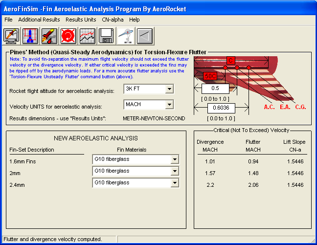

I'm looking at building a Purple Parrot as a 38mm MD.
I've done a whole bunch of sims but am not liking what FinSim is telling me. I've not decided on glue or fillet size at this stage, what concerns me is fin flutter and divergence. For those of you who don't have FinSim it is now available for free download, but be warned its not for the faint hearted.
Anyway here is what I am inputting. The flight should hit about Mach 1.8 at just over 3000 feet if flown at Westmar.

Fin thickness does seem quite thin, given the amount of sweep you have.
Since the stiffness of the fins is proportional to the cube of the thickness, you will get good bang-for-buck if you thicken them somewhat.
You could think of stiffening just part of the fin closer to the root. Add 0.5mm G10 each side, and fair it onto the thinner piece?
Other thoughts are to increase chord lengths and shorten span a little.

I know how to increase the fins strength OTT. This is the kits standard fins and I am pretty surprised at what I'm seeing here which leads me to think I either have not used the program properly or do not know how to properly interpret the results. One of the other things that concerns me is that I could not find any details about the properties of the G10 FG that are used by the program, this leads me to ask questions about are the properties used typical or are they on the safe (softer) side?
After handling the actual fin and testing its firmness by hand, my gut feel is that it would at the very least go Mach. The fin may be thin but it is also not that large so it is proportionally thick. By comparison my Flying Dutchman fins are 2.4mm but are sigificantly larger.

Hey Matt I had a look at the file and i'm no expert on fin sim but from what I understand you need to provide the method that the fins are going to be attached to give a flutter and more critically divergence speed. you had that set to the default "Elmers wood glue" with a 1mm fillet so I changed it to WS 105/205 and 5mm fillet and added a couple more thickness of the same shape fin as a comparison.
I can't compress files so I sent it back to you on FB. have a play with the AOA and the different fin thicknesses under the "Fin bending stress analysis" Button. Hope that help.

Details of the Fin Stress Bending Analysis screen are not saved into the file and these are not used to determine Fin Flutter and Divergence.
I think that the answer lies in understanding the materials and possibly interpreting the results.
