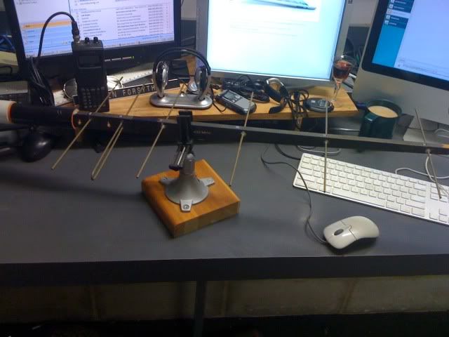

RADIOSHACK PRO 93
As it happened . I had also brought with me to George’s my own Radio Shack Pro 93 Dual Trunking 300 Channel Scanner ($20-00 EBay a few years ago) and a timber and 4mm brass rod five element Yagi Antenna, that I had constructed and used some time ago for other 433Mhz RF beacon sources.
(I regret only be able to a small fraction of features of this unit and would welcome a fast tutorial from anyone professing a solid understanding of Dual Trunking Scanners.)
We therefore decided to see if changing to this unit would give us any better a result with a the “Wooshtronics”beacon. Immediately when we turned the brass rod yagi towards the transmitter the receiver responded with loud clear tone, that remained constantly at about 20 Degrees of Beam regardless of the distance from the beacon.
Now all of these test do "live or die" in the field. We have as yet not tested either antenna a range of 1000 meter plus, in heavy woodland or through cultivation. I noted in your spec you listed your gain as being 3 db ? Surely you are mistaken or am I not understood your spec. I had always thought that most Yagi's were high gain antennas (10-16 db) with the higher the better. I have always operated on this assumption and I have no clear recall (this happens when you get older!), of where I picked up that concept.
It was then that I casually observed that while both antennas were five element Yagi (4 x Drivers 1 x Active Element and 1 x Reflector ) constructed to 433 Mhz, that they varied greatly in their overall geometry. As it had been some four years since my antenna had been constructed, I felt I should check my original calculations to ensure that I had adhered To my own calculations during the construction.
I have listed these details are below, along with a copy of my original calculations.
My 433Mhz 5 Element Yagi Antenna dimensions spacing and layout.
(Please note the differential between the spacing of my Reflector and the Active Element and yours)
I will readily admit to only having a rudimentary knowledge of antenna geometry and RF radiation patterns I fear I may certainly need to solicit the opinion and intellect of persons/beings, vastly superior to mine. I am afraid that my ONLY basis of knowledge was the little that I managed to glimmer in the 1970s, when I served as a radio officer in a CMF artillery regiment.
(OK let me just say that for ALL those of you who are now thinking. “Wasn't that NOT long after radio was first invented ” - all I can is - "That is COLD!")
I guess my rudimentary knowledge of antenna geometry is confined to derivatives of “quarter wavelength squared” type calculations. I therefore have been forced require all the published drawings, software like Quickyagi and on-line calculators, that have been cleverly devised and calculated by others. In other words I mean NO offense is questioning you antenna layout. Perhaps the width of the elements (being 12mm Flat Aluminum has a profound effect on the radiation pattern)
Click [b]HERE to see Basic YAGI Antenna Design Video[/b]
I am therefore at pains to be able to explain why there should be such a big differences in element spacing and length of an antenna that is constructive similar frequency range to mine. I also wonder the broad beam of your antenna could be effected by affected by the use of flat 12mm wide aluminum strips for elements in your waveguide of your antenna as compared to the 4 mm brass rod used in mine.
6 x 4mm Brass Rod, 1 x 1.6 Mtr 38mm x 12 mm Length Maranti spa; 1 x 40mm HD Conduit & End Cap; 1 x BNC RG-58 Panel Connector; ).5 Mtr RG-58 50 Ohm Coaxial Cable.
Any and all thoughts and comments are welcomed!

Re: Yagi Design to go with 433MHz tracker
Postby cryoscum » Fri Mar 04, 2011 6:06 am
Hi Tarp
Thanks for the kind comments, but please be under no illusion as to how much I know about antenna's! I received a lot of help from PK, Buzzard and Yagi design software. The software tool makes it easy to design a workable yagi with virtually any set of materials, gives you detailed construction info and then you need to just assemble it.
As far as the easy-as RDF's close range directionality is concerned, a critical bit that needs to be understood is that at close range the signal strength is so high that it basically gives good signal strength in any direction. Though this definately becomes more predictable at greater distances, the solution is to simply squelch the signal or, at really close distances, de-tune the receiver by say 0.005 MHz. The receiver will then be much more decerning where you point the yagi. This is actually very well explained in the packaging that the Easy-as RDF came in from Whooshtronics.
I must say that I would have thought you would have had more success at 150m, but again the squelch is the critical bit. I've used that rig on 2 occasions, once as a test in my street starting at a range of about 600m and then again at a recent launch of Helldriver, working from a range of maybe 250m. Both times the squelch was really enough, because by the time you got within 30m or so, you could hear the beeper. I reckon the system works very well
I'm heading over to George's this weekend and I'd be happy to demonstrate. As far as specific tech-help is concerned, I would suggest you talk to the blokes at Whooshtronics as they know this stuff cold.

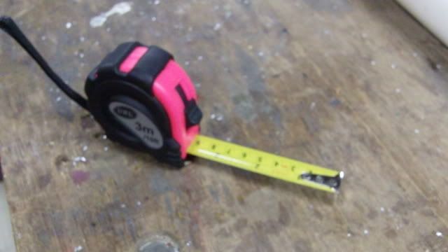

The ALL new $2 Yagi
Antenna Raw Materials
For the latest in RDF convenience......
SEE THE VIDEO
The challenge here is to see if any other readers can make one for less ......
Current place holder - $2-00
Bill of materials
1 x FBT Discounts 3-0 Meter 16mm Wide Household Tape Measure - $2-00
1 x length scrap Pine from bookshelves for handle - $0.00
1 x Waste 1990,s 10 mbps RG58 50 ohm BNC Coaxial lead - $0.00
1 x 450mm length of 90mm storm water pipe from builders scrap pile - $0.00
TOTAL - $2-00
