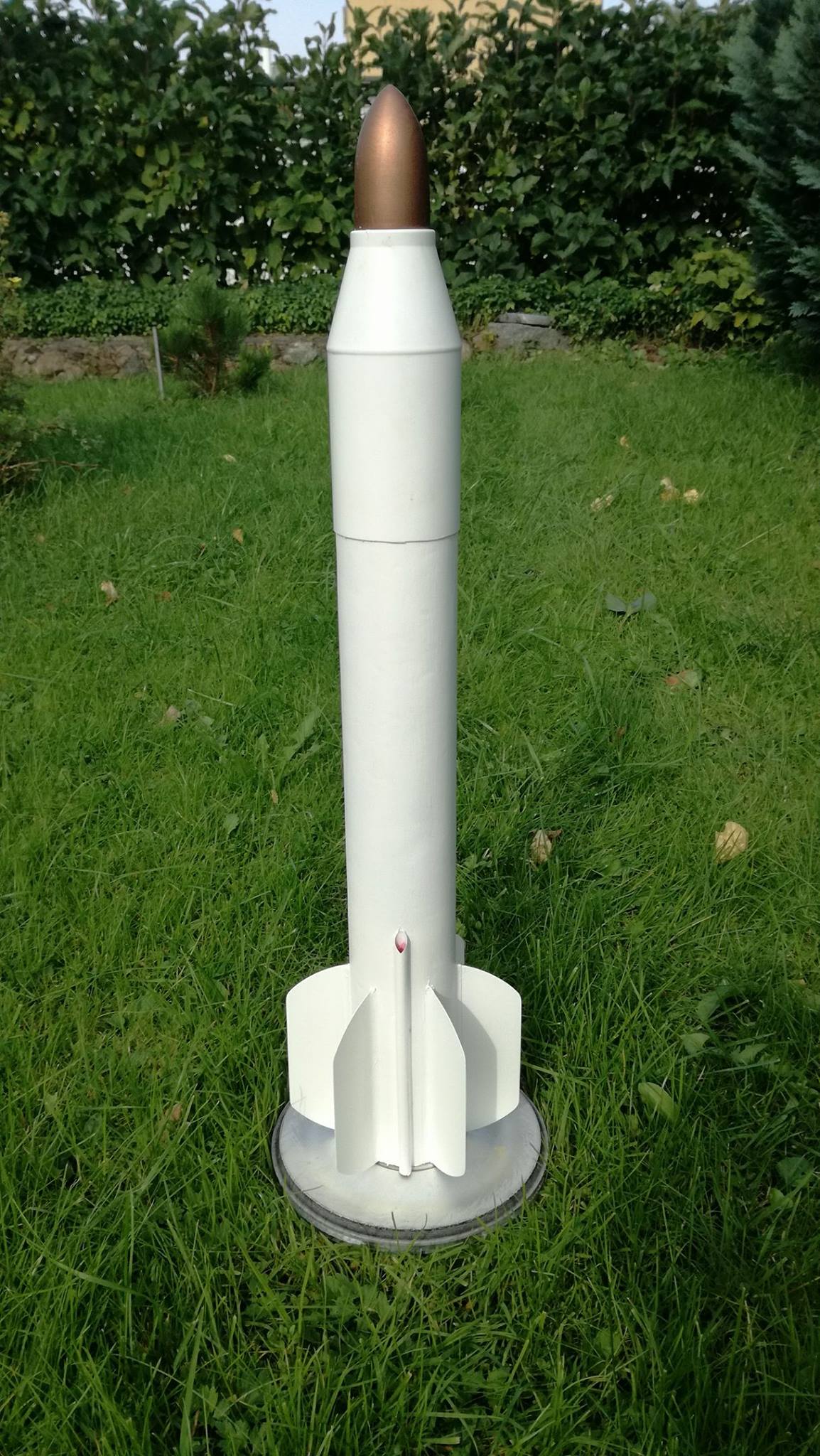

My friend works at DVD factory. I got some half DVD-s(0.6mm) and used them as fins on my rocket.

Neat idea, was expecting from the title to see very shiny fins.

These half DVD-s were not metallized so I painted them to make them visible. Next time he will bring me metallized ones.
This rocket on the picture is now completely broken. I used a paint that made polycarbonate fins and fibreglass body tube very very weak.

Did you get much/any flutter with the DVDs?

SpaceManMat wrote:Neat idea, was expecting from the title to see very shiny fins.
Yep - me too.
Otherwise, I don't see the point of using non-conventional materials of construction

These fins are very strong and stable when not painted with solvent based paint. Now I tried to use sandpaper to make them matte and visible. 3 and 4 fins version is also very easy to transport on a car rear seat.
krusty wrote:Did you get much/any flutter with the DVDs?
